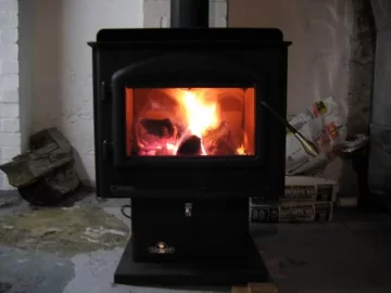

For a long time I have wanted a woodstove in my house. Several months ago I came to hearth.com asking questions. I aquired my familes old Dutchwest stove from my childhood home. I had intended to install that stove. But after many questions and replies from members it was decided that I should install somthing modern. And I did.
Here on the "forum" I learned how to do it right. whats a good install whats a bad install etc. Elki, MountainStoveGuy...and many others shared good info and steered me in the right dirrection.( Not to mention helping me spend a lot of $$$$$$) er Thanks
My new stove has been running for 3 days. Its working beautifully.
New car smell Good.....New stove smell Bad.....Luckily the smell has subsided and I`m enjoying the warmth in a T-shirt and shorts and having a cold one. I earned it.
I had to install a tankless hot water heater system that directly vents to the outside without a chimney. I also have a relativly new hi-efficiancy gas furnace that vents outside too. Then I had to reline the chimney with a stainless flue-liner for the wood stove. Saftey is my #1 concern, I spent a ton of $$$ before my house was even suitable for a wood stove. Saving money at the exspense of saftey is something I could not do even though I am on a tight budget. Well my stove has been running for 3 days and Its nice and warm and wonderful. And worth all the trouble I went through to do it right. I`m very happy with it. Its a Napoleon 1400p, 30 feet of Homesaver UltraPro 316 stainless flue liner. It draws great , lights easy and I can`t stop smiling.
Glenn
  • [Hearth.com] First Fire!!! New Napoleon 1400p up and running
All I have left to do is pretty up the stove area. Its in our semi-finished basement. More pictures will come in the near future when I "pimp my basement"
GG
Congrats,
Is that 2 pcs of 1"x4" shimming the side up under the pedestal? I understand its prolly temp, but you might want to use stone, metal or a few ceramic tiles.
Its metal shelving parts that are painted fake wood. You have a good eye.
The wall and floor are concrete and I have good clearance around and above the stove.
Saturday I will be pouring a concrete pedesistal to level the stove. I plan to repaint the basement floor and trim the pedistal with tile.
Thanks for noticing.
GG

Was just wondering. The fake wood is very convincing:)
Congrats again, sounds like you have a well thought out plan.

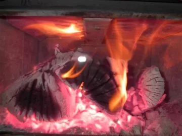

I'm a noob here, well posting anyway. I 'm spending my first winter with a Napoleon 1400 leg model. I have a 1300 sf. open floor plan house smack in the middle of cornfield county Illinois. It's 5 below outside as I type this, 75 inside. I rely solely on the little Napoleon, and it does the job wonderfully. I am fortunate to have 15 acres of woods surrounding me (red oak, shagbark hickory, green ash, wild cherry). Anyway, the napoleon does a great job. It's unbelievable how clean that big windows stays...I read about people having to scrape the crap off their glass with a razor-blade...not at all necessary with the 1400. I'm surprised it isn't more popular with folks, especially at its price point.
30cal said:
Hello all,
Welcome to the forum. Beautiful fire shot.
