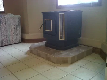

Did the whole install myself and built the hearth too. [Hearth.com] First post and first pellet stove[Hearth.com] First post and first pellet stove

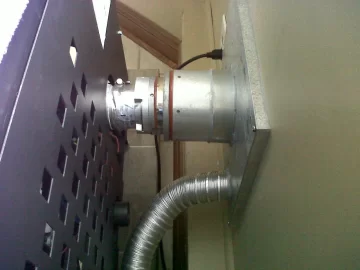

Of course i still needed to connect the fresh air tube.

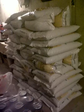

And my first ton of pellets "Canadian Bio Fuel"
Welcome to the nut house. Nice looking stove and pad too. Is that a window above the stove? Does that open? We are going to have to send you to pellet bag stacking school though. The pellet pigs on here will not be happy with the way they are arranged. That is bordering on pellet abuse. ;)

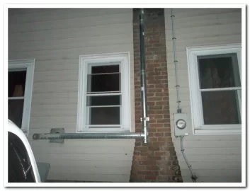

Very nice. I see you went with 4" vent.. How far up outside does your vertical go?

My venting goes straight out the back through the thimble, books a left out side, runs horizontally for 4' and into a clean out tee then straight up for 5' then terminates.
All that becuase I had to stay clear of the window that opens.

You could have went out the wall and straight up (eliminate the 4ft horiz) as long as the vertical went 1 ft above the window (granted it would have been in he line of sight).
Your EVL is around 17' if I have calculated correctly. Which isnt bad at all. But 4 ft of horizontal before your Vertical is not ideal.
