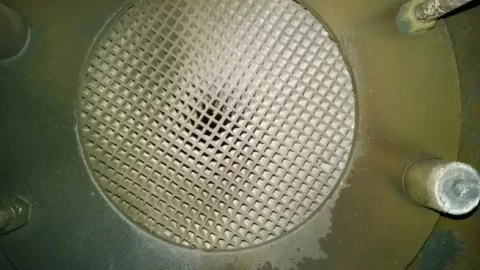

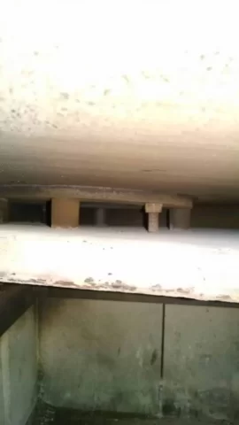

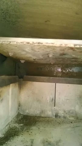

Ok, so after reading several places that the Cat will glow. I decided to investigate a little. I know i should have looked at the CAT before burning the stove initially, but i didn't know it existed. I pulled the plate and took a look for myself. All in all i think the cat looked good. I brushed it off with a paint brush and looked for any flaking or decomposition... I didn't see any. The only reason i can see that would prevent me from seeing the Cat glow, is that i can't actually see it period. The cat sits flush with the top of the inside box that combined with the angle of the plate makes it impossible to see from any angle. Unless there plates supposed to glow... If that's the case, I've got something wrong.

Cat does NOT have to be glowing for it to be working fine.
