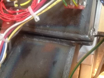

Greetings all, we had a 20 minute power outage a few days ago while the Harman was going full tilt. Flame went out immediately as you would expect. There really wasn't much smoke in the burn box. But after abou 2-3 minutes, a small amount of smoke started to come out of the side doors, especially the left side with the controls. Most of it was coming from the vents of the control board enclosure. No smoke at all from the hopper. This got me to wondering, if the OAK/burn pot/exhaust path is air tight (which I assume is true), where did the smoke come from?

Hi all, this was my original post. I took the stove out of the insert enclosure for the first time yesterday and found the issue that caused the smoke referenced in the original post. As part of the OAK install kit, there is a weldment that connects the outside air bracket to the stove. The kit comes with self drilling metal screws, but one broke allowing the gap shown in the pic. The installer is due out on Sunday and he will drill and tap for a machine screw. Posting for future reference of others.

After the fix you should check it again.. Did you get a UPS ??
Thanks for checking back in and letting us know the outcome
