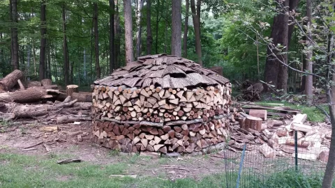

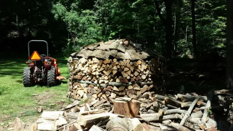

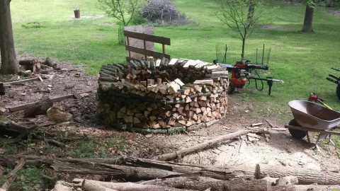

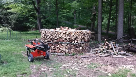

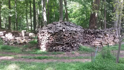

For the past year i've looked at these on "Hearth" and on the internet and they looked so cool i had to give it a whirl....it is comprised of red oak, ash, sugar maple, black walnut, and elm. the shingles are elm and ash skins

That is really something. You'll get to enjoy it for a few years and then slowly consume it like a dessert of some kind!
Keep saying I'm gonna build one. One of these days...
yeah its definitely more time consuming than normal row stacking! probably 15 hours all said and done throughout the last couple months chippin' away at it with splitting and stacking combined. it's 10' in diameter by 5' high (top of the wall) and i think i read somewhere that it should round out to be between 3-4cords? not sure how to calculate it to be honest.
Build a few of them and eventually you'll get to the point where it takes maybe a little more time to build . . . but not much . . . compared to a regular stack.
I've built three or four . . . mostly now I go with the regular stacks just because it is easier to do the measurements and figure how much wood I have.
Your holtzmiete looks very good.
Thanks!, yeah now that i got one under my belt i'm already thinking of another one in the same area. Still got a load of logs left sitting close by that need to be processed so will probably end up building one more.

Mine was about 8 ft high, there is a cylinder calculator you can google. You just need the radius and the height. I think it was between 4 and 5 cords.
Formula is simple. It is the area of the circular bottom multiplied by the height.
Pi times radius squared times height. If you want cords, divide the resulting cubic feet by 128.
I like the bark roof.
Thanks! yeah around here we've gotten hammered by EAB and now all of my elms literally have disappeared with i'm guessing a bad bout of elms disease in the last year so i assume both infestations have cut off the water supply up the tree resulting in the bark peeling off like butter during the splitting process.
That is way cool dude, you should post pictures over time to show how it settles with the drying process. Great job.
Thanks Bob, good idea I'll have to remember to do that.

Well its been exactly 11 months... held up pretty good. Will be interesting to see what the moisture content is in the middle.

LOVE the idea of using bark for the shingling. Very slick.
Don't fear math. :) Lets use 8' diameter house as an example that is 4' tall.
Radius = diameter/2 = 8/2 = 4'
Area for a circle = pi * radius^2 = 3.14 * (4')^2 = 50
Area of the base of the house = 50
Area * height = 50 * 4' = 200
To convert to cord / 128 = 200/128 = 1.56 cord
So, a 8' round by 4' tall house is 1.56 cord

Thanks! I've been worrying about whether that was a good idea or not, on one hand it is keeping most of the rain out, but on the other i'm wondering if its minimizing the amount of evaporation from burning off and escaping. I'll find out soon enough, got the moisture meter at the ready for October, will let you know some readings. I"m struggling with believing the splits in the middle of this are going to be good to go but i guess they've been building these for hundreds of years for a reason.
I envision the worlds biggest raccoon living in side. Ready to pounce as you remove the 1st split.
LOL, don't think for a second i didn't already consider wearing welders gloves up to my shoulders when i break it down.
