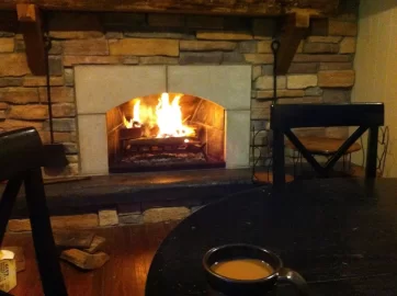

I had a little fire in the fireplace yesterday morning. It made it hard to leave for work! It was 49 degrees, why not. Right?
