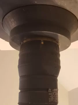

First post so I'll try to add as much detail as I can.

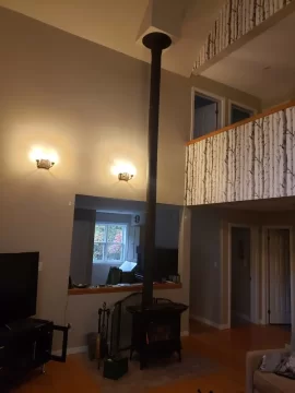

I've owned my house for about 10 years. The wood stove was installed by previous owner. Straight pipe from stove to cap.
We had a large amount of rain (2" in about 30 hours) and I had some dripping down inside the house down the stove pipe (not sure best way to describe) and resulted in a maybe a 4" diameter puddle on the floor.
The issue is this is just after I swept the chimney (from the bottom). Is this just coincidence that we had this huge rain storm and it leaked? Or could I have possibly damaged something? That's an open ended question for sure. We have had rain since then, but no noticeable leaks. We haven't had a fire in the stove yet this fall.

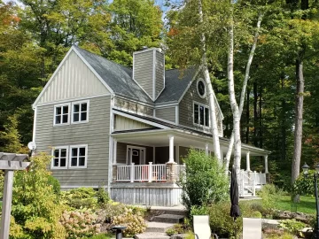

I did get up on the roof to do half an inspection and the cap seems intact. The caulking that I could see also looked fine, but I could only see about half of the top of the chimney, since it's hard to get up there.
The final question is about the transition at the top of the inside stove pipe to the through ceiling section. I don't remember if it's always looked like that. Could it have possibly shifted?
Thanks everyone!

It's possible something shifted, its possible that the water was a freak occurrence due to the heavy rain. Since you are literally playing with fire here and the lives of your family will depend on it, I'd get somebody out that can take a look at the entire system. Its not worth taking a chance that something was missed.
