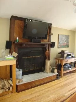

that fireplace with the ceramic insert, you'll likely need to verify the structure of the chimney if you plan to vent up and out.

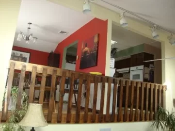

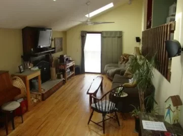

Thanks everyone. I think the placement where the fireplace is, is perfect. It's an open space - loft like - split level.
Yes I can turn off the baseboards in the rooms downstairs. The fireplace is directly across from the kitchen/dining area. and then the bathroom and master are to the right of the kitchen. And with ceiling fans that should help distribute, yes?

how do you figure out which stove you need? Do you have to PULL the current insert to measure out properly? Does the insert include the control for the flu (so would there big an opening left?). What stove we get... is it dictated by the size of the existing fireplace...? It just seems they have different features and price ranges, but they don't come in multiple sizes, right? so even if we want a more inexpensive one, we may not have a choice?? There are two dealers who deliver pellets. $200/ton. Do you have to burn specific types for specific stoves - they aren't interchangeable?? Can we store them in the center of the garage; meaning away from the outside so they don't get infestation... is that something to be concerned about?
They did quote about $750 to install the venting into the chimney. are there going to be any hidden expenses involved?? We need to take apart the wood front on the fireplace to get to the insert. I think my husband can do that so we preserve the wood.

I think you may be right on the insert but that thing looks 10 feet right in front of your face. No way I could sit that close to my stove but i've never had an insert so maybe no big deal.
Another thing is airflow. With that slanted roof the heat may just roll on upstairs but keep in mind you will probably need fans of some sort to distribute the heat. That's a constant theme here, "how to move the heat."

You will need to pull out the current unit to measure and find out what will fit. Usually... at least in the few fireplace stores I've worked at, once you put a deposit down on a unit you like and you are planning on installing it yourself and especially if you are having them install it they will come out and take the time to measure and see what will fit. They look at the deposit as a "commitment to buy" and become a lot more serious after that. Every consult I go on I take the time to pull the insert out and make sure something will fit, whether it be what your heart was set on or what will actually work. Don't get set back by the Quadrafire bashers, they are good stoves. I don't have experience with the big box stoves so I can't comment but pretty much any dealer sold stove is going to perform well if it is kept clean, installed properly and you are instructed how to use it properly. From what it sounds like as well if you don't mind turning a wrench on your own the Englander may not be a bad idea either. I've read reviews on them and a lot of it is mixed but overall doesn't look bad. A lot of the motors can be sourced through grainger or Rotom if you don't mind doing some mind boggling research and that can save you money.
