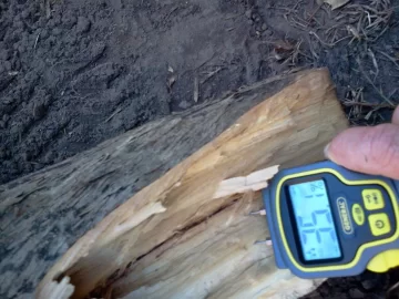

Bought a moisture meter to use for the first time. More out of curiosity than anything. However after using it, it changed my way of thinking. I had some cottonwood rounds that I had trimmed late last winter. The bark had already came off which used to be the signal that it was ready to burn.
Here is what the meter told me!
Have a tool now that is as valuable as any of my other wood cutting tools. [Hearth.com] First use of moisture meter

FYI, in the pic you've got the pins oriented about 90 degrees off from where they should be. Ideally both pins should be stuck in the same annual ring , i.e lined up with the length of the split.

Two good points, with the grain and freshly split piece.

My meter does that sometimes too. I'm not sure if the 4 pin models are more sensitive to that kind of thing, but every time that happens to me (mine is a 2-pin), it's when the wood is quite dry, under 20%, so I'm happy:)
Regarding the pin orientation, I did some testing on that, and every time the measurement with-the-grain was just a bit higher than cross-grain, so I do with-grain as it's probably more conservative and accurate.
Mine has never shown any difference in how I place the pins, it reads the same no matter how I place them.
