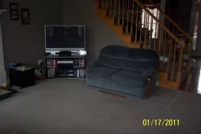

I'm wondering then about making it a one sided fireplace with a non-combustible wall on the LR side.
FWIW, out here if you were waiting for low propane prices, you would be in a very cold house.
Another question is how well the propane fireplace works as a heater and what is the btu output? I would expect the F600 to put out much more heat.
The vent-less gas logs do put out quite amount of heat, but do cost to run.

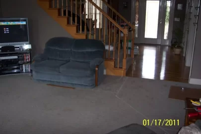

Just spoke to the wife, and thought we could put it where the loveseat is currently at. It would not be in the way of the main walkway, we don't use the loveseat that much, and we could look directly at the stove and see it burning where we currently sit. (The stove would be next to the TV, but we could keep it at least 3' away or more).
Moving the stove down the one wall to the right, where originally proposed, would take up the majority of that wall, and we would loose at least one main chair that the TV is viewed from.
Pictures attached.
Thoughts????

Where does the flue go in this situation? - block off the stairs??
The F600 is a pretty radiant heater. I would be concerned with the proximity to the TV. There are other stoves that are convective heaters that would be better in that location.
