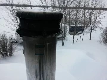

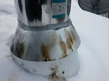

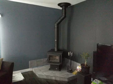

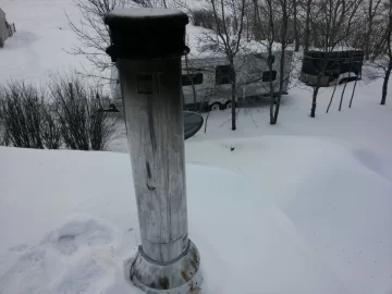

Hello. This is my first year of burning and I was outside moving snow today, looked up at my flue and noticed some brown gunk on the side of it. I attached some pics for you all to see. What is this? I stopped burning for now until I figure out what the problem is. Is it creosote? The main pipe in my living room sounds hollow when I tap it so I guess that means is empty? I have attacked pics of the stove in my living room. There is only about 6 feet of stove pipe coming out the roof

Creocicles, nice!
Can come from;
Burning in very cold and wet weather so cap gets very cool and causes creosote.
Moisture in wood (even recommended 20% moisture wood has water) forms dirty icicles on very cold cap.
Burning less than ideal (green) wood or too much smoldering of the load by shutting air too much.
Can be 1 or combo of all. From your pictures that looks like it's time for a mid-season cleaning. How much and what kind of wood has been through the unit and when was that wood cut, split and stacked (CSS)? Hardwoods take about 2 yrs to season to 20%.

I think jatoxico pretty well nailed it.
Time to clean the inside of the pipe for sure to see what else is in there.
The outside stuff, to me indicates the very top of the chimney was cool enough for water to condense and glom onto smoke particles as it was condensing. Time to figure out how much of that is/was happening inside the chimney pipe as well.
Might be just run the stove hotter on those really cold nights, might be slightly too damp wood night after night after night.
I do encourage you to get it swept sooner rather than later, careful inspection of the sweepings might tell us a lot about how the pipe got to there.

doesn't really look that bad at all, actually looks pretty good to my eye, It must have been really cold out and the smoke coming out the chimney condensed and gave you those creosicles.

I saw some of that brown crap in the snow on my roof around my pipe when I was out shoveling yesterday. The weather has been been horrible here extreme cold and massive blowing winds. I figure the exposed part of my chimney struggles to stay anywhere above freezing temps and the snow is blowing all around my cap .... end result is when I burn at the hottest temp of the cycle the cap defrosts ice and crap on it that has been discolored and it drips.
Good job getting out there and sweeping. Doesn't look bad to me either but you don't know until you check it. From the looks of it the cap was ready to clog which would have put you out of business no matter what the pipe looks like so it wasn't a waste of time. Maybe you can find a cap that can tolerate your conditions better. Can't tell from here if it was a wind issue or snow on the cap itself or just too restrictive.
