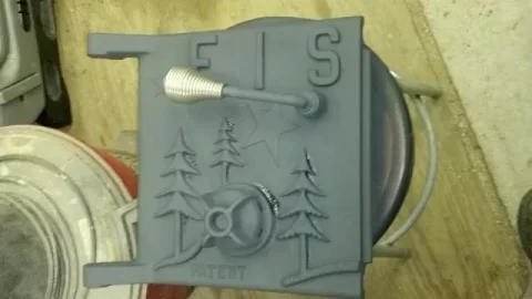

I just starting fixing up a Grandma that I bought last week. I have been looking through all the Fisher threads, even ended up reading the book and the news articles. I am always tinkering and rebuilding stoves, but this is my first Fisher. I think this one might be a little odd, from what I have read. It measures 25 1/2" across the top. It has a baffle, it appears to be be a factory piece, it sits on a piece of angle iron on either side that is welded to the side at an upward angle. It also has a single firebrick mounted above the lower row, in the back but not quit centered in the firebox. It's corners are angle iron that extend all the way to the floor, they do not taper. The legs have a ferrell welded on the back side with a piece of all thread for leg levelers, the chrome caps are threaded onto the all thread. Has anyone seen these features on a Grandma? I thought someone might know some back ground on it. I can't find my camera but I will try to get some pics tomorrow.
