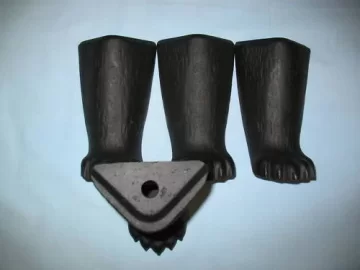

I noticed in the picture that the "claw" feet look like they are cast on that unit.
Mine has the plated "overshoes" that the legs drop into.
Will let you know what I find under the paint.
The 2 styles of cast iron legs; Both are marked Fisher Stoves on back side.
