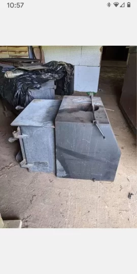

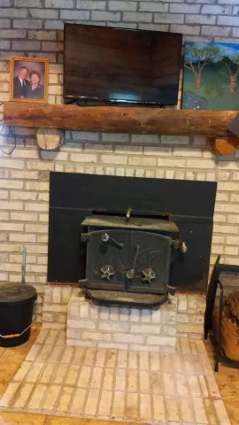

Is this a decent buy? Pickings are slim where I live on used inserts. Most of the ones I see are in rough shape or are too big to fit my fireplace.
This seller has it listed for $475 OBO. I measured, and I'm sure it'll fit my fireplace in the house I just bought. I have a local chimney sweep company who will properly install and inspect whatever woodstove insert I buy for $3500. It does look like it needs some brushing and painting. I have a 2100 sq' home heated with a 90s electric heatpump. So this would be a backup/auxilliary heat to lower the heat bill in the cold months. My chimneys are in sorry shape, so the sweeps recommended an insert if we wanted to avoid a much larger repair job. (Other chimney has a propane ventless logs setup we are going to keep the way it is.)
[Hearth.com] Fisher Insert: Should I get it?[Hearth.com] Fisher Insert: Should I get it?[Hearth.com] Fisher Insert: Should I get it?[Hearth.com] Fisher Insert: Should I get it?[Hearth.com] Fisher Insert: Should I get it?
Is this a particularly tall chimney? $3500 seems a bit high for installing an insulated liner. Make sure that includes the cost of the custom transition piece to connect the insert to the liner.
Fishers don't need a custom boot or anything. A standard 8" appliance adapter can be notched around the damper rod and slid in. I find they work best on 7" liners. But still $3500 does seem high

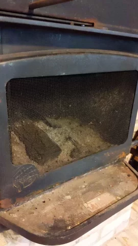

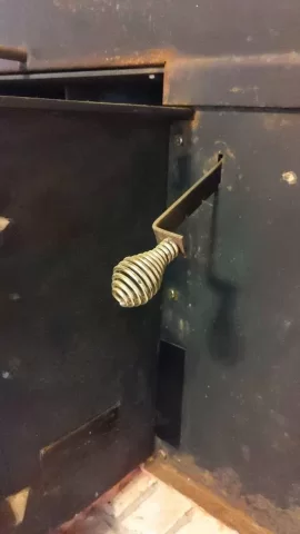

I am confused by the 2 damper controls though
Fireplace damper? If they didn’t flip the pics is not on the stove in the picture with it removed.
The one on the side is the standard location for fishers. The bar ontop in the middle isn't. That is where Alaska's had theirs.

This Insert is missing the diverter plate above Insert. This part prevents heat from rising up fireplace front under mantle. It is required for a legal installation. The fire screen for fire viewing may be missing as well. No mention of optional blower.
If the glass Insert posted from Facebook Marketplace is available, it is a much better deal. Make sure it has a UL label if required by the uniform building code adopted in your state. The blower could cost 200 alone. Notice in the second picture posted on Facebook from the “Wood Heater Leader” poster, the diverter is shown above the Insert.
It is advised to add a blower when installed in any hearth, but not necessary. Unlike modern flush mount Inserts, the Fisher uses radiant heat from the front half extending out of the hearth. This has the ability to cook on the exposed stove top and radiates into the room without the need for a blower during a power outage.

An Insert has a double wall with air chamber around the firebox. There are openings top and bottom for air to enter and exhaust the heated air into the room. This is convected heat from convection compared to radiant heat from a wood stove that radiates in all directions.
You don’t want to radiate into the fireplace masonry, you want to heat the room. Heat radiated into masonry also radiates upward through roof and worse, to the rear when an exterior fireplace is used. A close clearance to a stove in an enclosed place such as a fireplace hearth is extremely hard on the stove. They are designed to radiate heat off each side and back.
When a stove can’t radiate equally in all directions the front cools by radiating forward and the back stays hot. This uneven heating leads to warping or cracking welds due to uneven heating. Always allow at least 3 inches air space between stove and non combustible material for the minimum air circulation.
Most new Inserts are convection only, almost flush with hearth front. A blower makes a huge difference moving the convected hot air out. The Fisher is designed with a single wall firebox in front that protrudes out of the hearth to take advantage of radiant heat and give you a cook top. The back half uses convection heated air out the top slot and cooler air closer to floor level enters under ash fender (shelf) or is helped even more with a optional blower.
Most of the heat comes from around the exhaust outlet pipe. You can see the pipe looking into the air slot at top. Moving air across this pipe with a blower extracts the most amount of heat into the room.

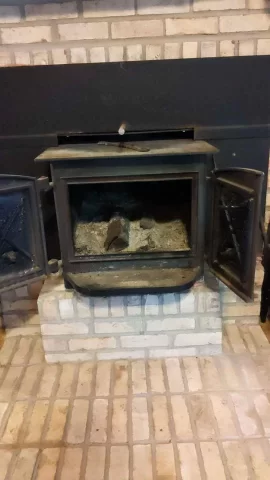

Ok. So I ended up getting the one I originally posted pictures of. The other guy's was extremely rusty, he finally admitted. This one needs a little sanding and painting too. But the lady who sold me this one did reduce the price down to $350 due to a Trump bumper sticker on the back of our pickup truck. Lol. She did have the air deflector. The only thing it's missing is a blower and firebrick. I can easily pick up firebrick in town.
Dumb question though, where does a blower attach if I get one like you mentioned? On that lower right side where there is a gap? Or on top? I was looking at heat convection powered fans but they look pretty dinky. Does something like this work? Do you just bolt it on?

There were a few styles made. If there are no slots along the sides of the Insert through the faceplate you use the long slot across the bottom.
Here is a thread showing the best home made blower I’ve seen. I later posted pics of all the different types in the thread.
I should add, it takes a high cfm blower for an Insert. 225 cfm is best. They all had a variable speed control so when the fire is low you can slow it down. Overnight about half speed is quiet compared to running any full speed.
This one is only 135 cfm.
It takes a much larger one than the one you linked in the post above.
Woodmans Associates has much larger and will be twice that price for what you need.
Notice in the thread I linked above I posted the original template for making a sheet metal duct for the bottom intake if you can’t find a blower to mount into the slot.
