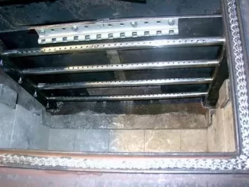

Here is a pic of the baffle with secondary air I made for my fisher Grandma Bear stove. I am not sure if it reduced the wood consumption but is does seem to produce a lot more heat. The stove top temps went up and the flue temps went down.
Then old fishers were great heaters but they would use a lot of wood compared to a modern EPA stove.
My stove never had a door gasket ( the stove was here when I bought the house), I did install one, when I did the baffle mod, not sure it made much difference as the doors fit pretty tight without a gasket. (You can see it in the pic)

No sh_t?
