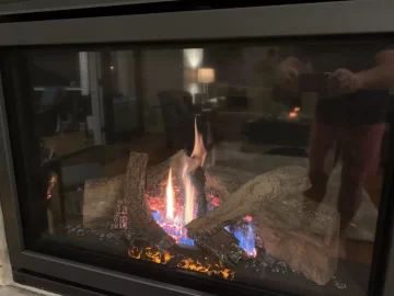

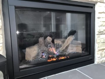

I suppose a picture would help :) See attached. Thank you

How do you turn it on? Remote? The pressure out, pout, needs to be measured. If that is correct and flame is small you could have a blockage or wrong burner orifice. Some manufacturers make it hard to measure that. Agreed flame looks small.

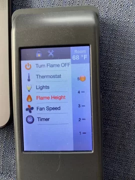

I use a remote to turn on the fireplace and control the various functions. Raising or lowering the flame with the remote does nothing noticeable to increase or decrease the flame. I have the tech from the fireplace store coming back again this Thursday. The tech was here last week and tested the fireplace gas line and informed me I had 4.5 WC coming in. Now the I have 7.5 WC coming in I am very curious to hear what the tech says now about the low flame.

4.5" wc coming in, was most likely ok. Most fireplaces run 3.5" wc at the manifold. This would allow 1" wc drop across the valve. Putting the gauge on the manifold port while running the fireplace will tell you right off if it did not have enough gas pressure.
The picture could be better, but i see some blue flame that should have some rock wool on it.
The venturi air adjustment could be adjusted, but it is usually set for NG from factory.
I would keep after the install people. They did a lousy job setting up the firebed....
