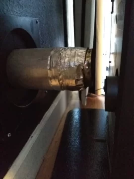

Hello All,
The exhaust pipe on my new stove is about three inches shorter than my former. Is it possible to use flex pipe to make up the difference? Thanks! Ben
  • [Hearth.com] Flex pipe for Pellet Stove (new stove height difference)
Unfortunately no, easiest thing to do would be a raised hearth.
Reactions: vinny11950
Raise hearth or just raise the stove by putting it on blocks of stone or cement. I used blocks for my P43 to raise it 2". P
Flex pipe would be a no go.
