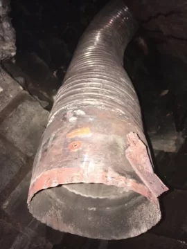

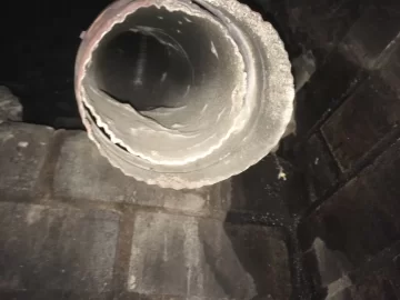

This is whats in the chimney now, looks like an inner layer is popping out due to where it was crushed while installing.
This is a little different then the flexi stuff
Looks like they smashed it against the firebrick and kinked it. Either more bricks needed removed, or an elbow was needed.
So much room too, maybe they did it b4 removing more brick.

Hard to tell because it is so dirty but it looks like the 2 ply smoothwall crap. I wouldmt use it.
Yup i think its that. A self tapper pushes inner section in instead of drilling through it
yeah the worst type of liner available on the market without a doubt. And screws should not be used with it at all.
No screws on the light wall stuff either right?

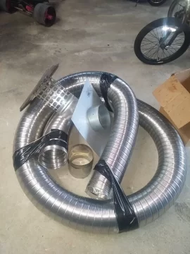

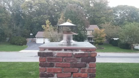

Went and picked it up this afternoon, magnet doesnt stick. Well just use the liner and cap from what it came with, although cap looks like it may clog easy.
You think the drolet will come with a clamp style appliance connector?
That cap doesnt look to bad the holes are pretty big It will probably be fine. But it looks to me like that top plate is meant to be attached to the liner with screws. You should get an appropriate top plate and appliance adapter with clamps on not the type that gets screwed on. Screws just dont hold in lightwall liners.

Yes we're gonna do the same deal as mine(pic above) and order the correct appliance adaptor also.

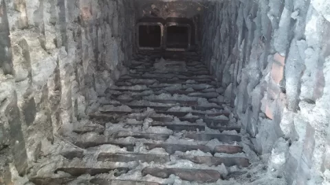

My projected plan is to remove the clays down to the last ones that are cemented in and only insulate above that, this will leave 5' or less un-insulated close to stove.
This seem ok or should i knock out those cemented ones like i did on mine? That was a pita! Im guessing those cemented clays are 3' below gutter in pic.
I think we can also squeeze up through damper area and roxel exterior brick where liner wont be insulated

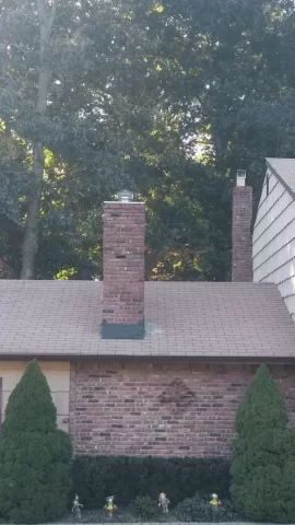

Im gonna help my neighbor install an insert the way i did mine, removing clay liners, insulating and what not.
Was gonna use the same liner i did from sleepyhollow chimney supply but found 16' of this flexi-liner and cap on local listing for 100 bucks. Should we just use this liner and insulate it or go for the heavier stuff?
