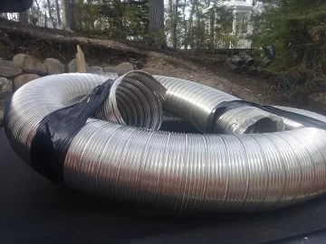

Im gonna help my neighbor install an insert the way i did mine, removing clay liners, insulating and what not.
Was gonna use the same liner i did from sleepyhollow chimney supply but found 16' of this flexi-liner and cap on local listing for 100 bucks. Should we just use this liner and insulate it or go for the heavier stuff?
Thanks!

That's a nice find. Based on how I run the stove and burning dry wood, I'd grab that liner in a heartbeat, especially if the neighbor is trying to save some bucks by going with the Drolet and having you help with the DIY install. On the other hand if the neighbor is going to burn poorly seasoned wood and maybe has a sweep that's aggressive with the brush, then a heavy liner may be a safer bet.
We'll be the sweeps for chimney cleaning.
The guy got the liner up in vt where his other house is, liner itself didnt say flexi-liner but the top plate did so thats what he told me the make was
It does look like a legit ss liner for wood correct?
There is no way for us to know that just from pics. But if it is stainless and non magnetic it should be fine. The only stainless that isn't very good for wood is the stuff made for gas which I ant remember the alloy right now. But it is easy to recognize because it is magnetic.
