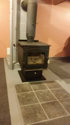

I am going to tell you about an issue I had running 6" pipe to a larger flue like you say you have.
I found much better operation by putting an adapter right on top of the 6 inch outlet of the stove and running 8" Pipe all the way to my larger
masonry flue. I switched back once and again I was having trouble so I am sure it helps.
Look close at my pic of my stove and you will see my adapter is right on top of the stove.
  • [Hearth.com] Flue Damper on Energy King Legacy 2150
