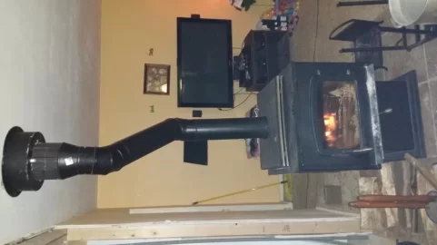

It looks like each of the double walled 8" chimney pieces is 30" and there is 5 so 150" of chimney. About 60" outside and the rest through the attic. Attached is what's down below.
I saw the stovetop temp reach 400 today. It's warmer here by quite a lot ... in the 20s when I was on this thread before and windy .... today in the 40s with little wind.
The chimney itself is not exactly straight up and down I did notice that....it's at a little angle is that causing a big problem where the wind is getting back in????

I should also mention there is a metal bar that runs north south through the center of the stove that is currently not attached. The previous owner said he ran the stove without it. I am running it without it because I don't weld...yet. I am not really sure what this bar is or it's purpose. Quite honestly, I put the stove in and fired it up because I wanted to gain knowledge...now I think I'm ready for more knowledge. Right now I have a little knowledge and you know what they say about a little knowledge right? This clearly is not my field :D
