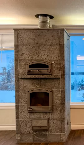

Hello! I'm in the final stages of buying a home that contains not one, but two Tulikivi stoves! It has a model TTU2700/5 and TU2200T/51. The house is 5,000sqft. and ICF construction. It is in central AK where the winter temps typically hang around 0 - 25 above with a few weeks every year of below zero. The two Tulikivi's are located on the first floor where there is a concrete slab, but there is an upstairs as well. My question for anybody in the know is just how efficient are these at heating large spaces? The home's primary heat system is a hydronic in-floor system with an oil boiler. Being the fact that oil is what it is, I'd like to use as little as possible. Everything I read online about these stoves says they are amazing, but I'm just wondering will they radiate even to the upstairs? The previous owners are out of the picture and I can't ask them for any help/advice, but I did see oil receipts for 2 years with no wood supplement used and their heating oil averaged $800/mo. Again, that's with no wood being burned. So I'm wondering, if I use the Tulikivi's regularly, one, maybe 2 burns/day in the winter inside of an ICF home, how much could I expect to reduce that monthly oil cost?
TIA!

Unless their stone construction goes thru the floor they won't radiate upstairs.
But air might convect upstairs thru stairs etc.
This depends on the layout of the home.
I had a tulikivi for 15 years. I loved it!! It absolutely heated the whole house perfectly evenly. You are lucky!
BUT I had a superinsulated small house with a small heat demand.
Tulikivis do not have a high BTU/hour capacity compared to a big modern wood stove, so if you have a huge heat demand these may not heat your house. You could build two or even three fires a day I guess and push it. I only built one fire a day, very rarely two.
The tulikivi was perfect for me since I could burn wood, which I had plenty of, and distribute the heat from maybe 20 or 25 pounds of wood over 24 hours in that house with low heat demand. I made a fire once a day. If it was sunny and not below zero, sometimes I could skip a fire. The temperature in that house stayed quite even. My heating with the tulikivi was often as much anticipatory than responsive. I looked at the forecast, planned for the heat demand of the coming day.
I burned almost all poplar. There were always poplar trees either falling down or begging to be cut down at my place. The poplar was perfect, because it dried well, burned hot and clean, didn’t coal much at all. I had a full closer damper, so as soon as the fire was burned out — an hour or hour and a half or whatever — I shut the damper all the way closed to keep the heat from going up the chimney.
You want wood that is dry and split small. I also burned a lot of small rounds. You don’t want, I don’t think, a long lasting fire with big logs. That might work OK and I might be wrong, but that didn’t seem right to me.
