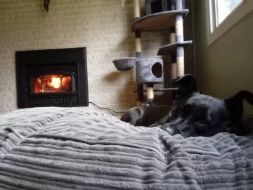

Secondary tubes are working as they should. No visible smoke from chimney once it gets going. Started using "top down" fire starting method and very little smoke produced during starts as well. Very pleased with the unit. If I have a complaint it would be "overnight" burn times, though I knew that going in. Catalyst hasn't been an issue so far, knock on wood it remains that way.

Now we're talkin! Nice secondary burn there. I think I'm between the Rockland V2 and the Hearthstone Clydesdale. I think the Clydesdale would allow longer warmth, but it's a bit chunky/clunky looking, perhaps requiring a little more attention since it has a bypass. The Rockdale is a looker. Glad yours is running well. When you have it running as in that video, is it pumping out pretty good heat? About how many hours can you get when you load it up - from high burn to a few embers?

It runs at a steady 450-500 according to the thermocouple included with the unit, but to be honest, Jotul isn't really clear what the thermocouple is actually reading the temp of. I assumed it was post cat burn, but the numbers don't jive. With the cat glowing brightly I've never seen the thermocouple read over 575, so I am going to assume it is reading surface temp. In real world performance, it has been keeping my little bit under 1400sqft house in the low to mid 70's with an outside temp around 35. House needs replacement windows as still has single pane glass with insulating film. Windows are hopefully next on the list of to do's. I fill the unit between 9 and 10pm and most mornings around 5am I have a pretty decent bed of coals, house will be in the high 60's. I'd say I could probably let it go for 8-9 hours and still get it relit with the coals left glowing.

Interesting that you're seeing lower temps even though you are achieving secondary burn and the catalyst is visibly active. Seems like the absolute temperature might not be a great indicator for you depending on where it's actually measuring, but that it might help you know that your burning well, e.g., even 500ish = good performance on your cat.
