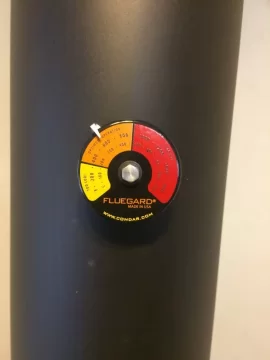

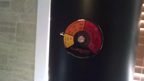

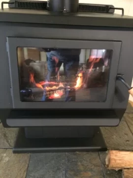

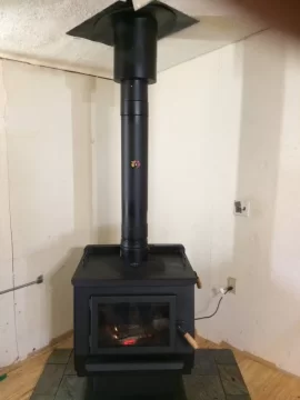

Excuse the mess. This install is where the old BTU waster fireplace resided. I plan on installing stone veneer along the back corner. All pipe was Selkirk Ultimate One. SS outside stack and double wall inside with inner SS liner. I was torn between what stack height to go with 12 ft or 15 ft. and went with 12 ft after I saw the incredible draft on a cold stove....very happy so far! BTW....flue probe was set at 24 in.

Congrats on the new stove.
Curious about the 600º flue temp. Was this with the bypass open or closed?
600º flue temp? Was this with the bypass open or closed?
closed...it is holding steady at 500 now.The cat is glowing a steady orange and it appears to be cruising right along...is that to high?
Don't know, that's why I asked. May depend on the thermostat setting and a new stove will have a strongly active cat.
I had the t-stat set at the 3 o'clock position initially(when pic was taken)and it is now set at 2;30 and is running at 500 and holding steady and this is a brand new stove being fired for the first time today

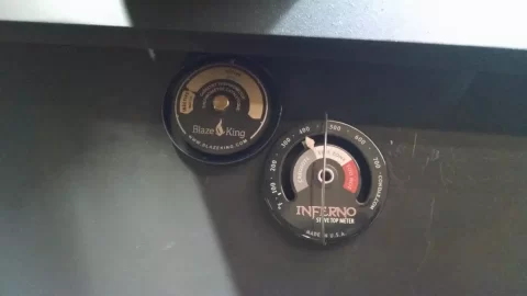

here is a different scenario.
