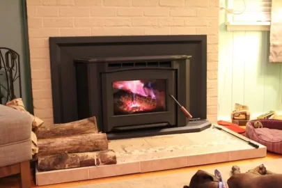

I'd like to figure out a way to read flue temps on my new Enviro Venice 1700. Flue temps seem to be a good way to compare different stoves and begin to analyze overfiring. If I place a thermometer on the front or top-front of the stove then I don't think I will be able to compare those readings to woodburners who are reading their exterior stove temps from the top-center of a stand alone stove.
Is there a thermometer out there that I can place on the flue pipe inside the fireplace and then run a heat resistant wire out to a display which would be visible from the front of my insert?

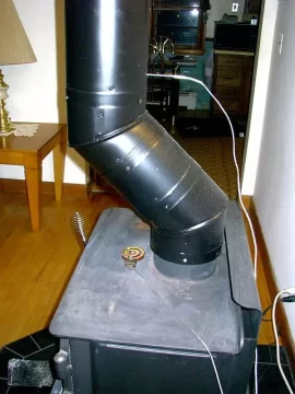

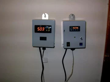

Here is what I put together to read flue temps, I have a freestanding stove but this should work fine on an insert. I have a thermocouple probe in the flue, and a magnetic mount thermocouple on the stove top.
The monitor/alarms will show temp on a digital readout and sound an alarm if the temp gets too hot.

WOW that is impressive.
any chance you can give us a rundown on the parts you bought for that?
i would like one if it was a bit more compact for the external read out / box
I'd like the parts list on that too. I'd love the piece of mind that an alarm would offer with my wife and baby in the house.

The one on the left comes from: http://www.coleparmer.com EW-93520-01
It is a nice unit, as it has a built in alarm, and only needs 120vac power and a thermocouple.
The only thing I don't like is the alarm is not as loud as I would like.
The one on the right is similar to the controller in the link from Granger ( only a lot cheaper),
It needs an additional peizo alarm, relay and pushbutton and thermocouple.
I have been searching for some less expensive componants, I have some parts on order to build another unit. I will see how that works out.
