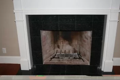

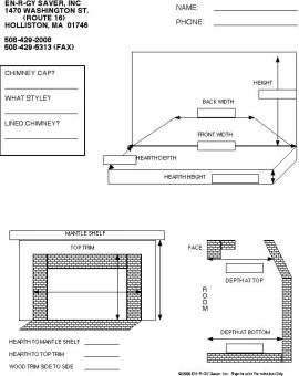

I just started researching wood burning inserts and became very overwhelmed. I am not very knowledgeable on fireplace, since I was born and raised in the south. I am looking for an insert that not only looks elegent but provides heat. We have 3700 SF open floor plan house that we would like to heat as much as possible ( I know the insert will not heat the whole house, but could help cut some of our heating cost). I like the models that are flush mount and have large viewing windows like the Wittus H530, Rais 600, and the Morso 5660. I have attached a worksheet with our dimensions and a picture of our fireplace. Does anyone have any experience with these models that could provide some information or guidance? Thanks

Sorry, the dimensions did not post correctly.
Height 29
Back Width 21.5
Front Width 18
Hearth Depth 24
Hearth Height 0 (Flush to floor)
Depth at Top 18
Depth at Bottom 20
Hearth to Mantle Shelf 54.5
Hearth to Top Trim 42
Wood Trim Side to Side 54

Did you reverse the back width and front width? The rear seems narrorer than the back, and if so, it seems to be more than a 3 1/2 inch difference (21.5 frt vs 18 rear)
Ah, that sounds more like it. I ran into a same situation as you, as my front was 36", rear was 18" so it tapered a bit like yours, and the height was 27".
The key propblem that I had was finding an insert to match the rear width, so what I did was I took some graph paper and made an exact print of the floorplan of the fireplace...looking from the top down. After making a "blueprint" sort of speak, I was able to look through all the specs of each stove and determine what would fit/wouldn't fit due to the dimensions of the fireplace.

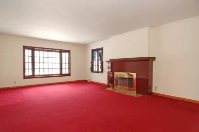

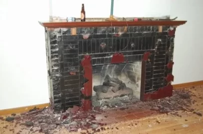

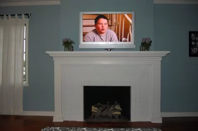

The problem I now realize is that I have the added wood that is about 18 inches from the opening, and the plasma above the fireplace. The mantle should shield it from heat since it is recessed by about 2 inches from the edge of the mantle. I'm not about to redo the mantle after who knows how many hours scrapping, $100 piece of 2 inch top trim, more trim, and painting... We plan on using this as a formal sitting room and the new TV room in the basement remodel in process, thus I'm not too worried about the TV.
Picture before, after taking the god-awful gas insert and lava red tiles off, and finally the finished product:

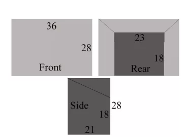

Here is a quick sketch in photoshop of the actual opening. I'll look into the Jotul. My house is a ranch, 1800sq feet on the first main level, finished basement (1000sq feet), and unfinished attic that eventually will be finished. I want to heat the main level with this stove, and eventually add another upstairs. The downstairs stays relatively constant and am not as worried about heating it.
I appreciate any suggestions and thanks for the advice on not chipping into any of the brick.
