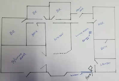

Here is what we are going for. We live in SW Idaho, winters are mild to cold. Most days are in the 30s with lows in the teens. We will go weeks, or months like this year with highs in the teens to single digits to lows below zero. We have a 2300 sq/ft house (not to scale floor plan attached) that was built in 2008 that is pretty tight except for a little draft around the front door.
We want a wood stove to help our heat pump during the winter. It wont be our main source of heat, but I wouldn't mind if the heat pump rarely turned on!!
After reading through the posts, I narrowed our search down to the Englander NC30. It's listed at 2400 sq/ft, and isn't to bad to look at. The problem is, it wont fit where we want to put it. The hearth will extend way beyond the path to the laundry room. So, we are thinking about the Englander 13-NCH that's listed to heat 1800 sq/ft.
So, my question to the experts is this: After looking at our floor plan, do you think the Englander 13-NCH would be a good pick? We wont be trying to heat the very back bedroom, as its occupant married and moved out!
Any suggestions to stoves or ways to move heat would be taken to heart. Also, one of the return air vents for the heat pump is about 15' to 20' away in the same room (marked on the floor plan). I have read that some folks say it works to run the fan of the furnace to move heat, and some say it doesn't.

Welcome. If possible it would be better to locate the stove more centrally and run the chimney straight up through the house. That will heat the best and will make the chimney warmer, but more pleasing on the outside. I see a couple other locations that might be better. Any room on the wall dividing the kitchen from the living room?
With a heat pump system you may be able to use the fan to circulate heat if the ductwork is well sealed and insulated.

Thanks! I still plan to run the pipe straight up through the roof even if the stove stays in the corner.
The floor plan is not to scale, so while the location on the wall between the kitchen and living room would work, the hearth would protrude out into the living room (wife inst so sure about that!). What makes that a good spot for the stove? Is it that its a straight shot to the air return?
I got a cardboard box similar in size to the stove and cut a piece of cardboard the size of the hearth requirements. Just move it around and see where it may fit best. The 13 may claim to heat a bit less space but it holds considerably less wood and I think you'd be loading constantly.
A centrally located the stove will be better for more even heat distribution throughout the house, even without the hvac fan. Depending on the roof layout and pitch it will probably look much better from outside too. The more of the flue that you can keep in the warm building envelope the better it is for draft and keeping the flue gases hotter. This can reduce creosote buildup.
The stove should be located at least 10 ft from the return air intake.

I would like to put the stove near the center of the house, but the only room I can think it will go in is the living room. The TV room is to isolated with only one opening to the rest of the home. We will try the cardboard idea! And I'll look at the other stoves suggested.
With the stove in the corner like it's laid out now, do you think with the fan running it will push heat through the kitchen, down the hall to the bedrooms?

The position of the stove now is on the back of the house, won't be an eye sore from the road.
It will be hard to tell if you are talking about the fan that will come with the stove ( Englander ). those fan help to move heat from the stove area but not near like a more convective stoves. Plus i have to tell you they are noisy and more if you run it on high.
Reactions: woodfreak666
It will help a bit to have the stove pointing that direction, but the long hallway will cutoff heat going to the bedrooms.

As far as placement I would shoot for to the left of the window if you can, also I would stay away from window areas due to blinds and curtains (potential fire hazard) for the hearth I think the 13 needs a thicker one than the 30.
Thanks for the heads up about the sales!! We did decide to move the stove over to the left of the window on the back wall. The corner just didn't work.
