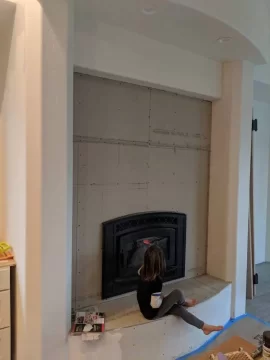

Here is the pic

The pups happy, and already daydreaming of warming that belly in front of the fire.
Let me know how you like the Craftsman, I just purchased mine and will be getting it installed in a few weeks. One item I noticed though is in your picture it looks like you have built your raised hearth out of wood. I think it is supposed to be non-combustible from the bottom of the fireplace up to 7 inches on the Craftsman.
Should be ok as long as the top surface is non-combustible. A 1/2" layer of cement board under the tile or hearth brick is sufficient.
