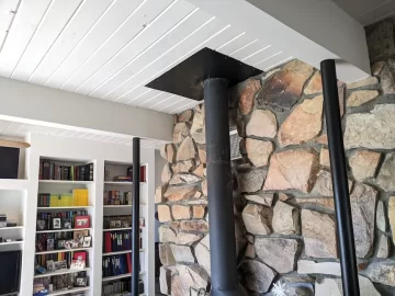

Hi all! Been quite a while since I have posted in here, as I sold the last home that had a wood stove (Jotul F100)... which many of the great members here advised me on as I was installing.
Anyhow, I am in escrow on a home that has two wood stoves. One of the stoves has me thinking I am likely going to want to replace it. I believe it is a Portland Stove Foundry branded Franklin type stove. I did a little digging, and it looks like it is meant to be used similar to an open hearth fireplace? With a screen, I suppose... do I have that right? There is no viewing glass.
I see some evidence of smoke/soot on the rocks, so I assume this thing will smoke and puff.
Like I said... likely to be replaced, but was curious about operation and safety concerns. Any insight? Appreciated!

Have both stove chimney systems inspected. They may not be to code. Definitely not if the stove pipe goes up past the ceiling. Clearances look too close, especially if that is a stone veneer on wood stud wall.
The old franklins like this were leaky and best run like a fireplace with a screen. A modern replacement will burn a lot cleaner, use much less wood to produce better heat, and there will be a nice fire view.
Had the home inspection yesterday afternoon. The home inspector did call out clearances and safety issues for that stove. Said it wasn't the first Franklin type stove he had seen in the area. He recommended I get the local stove installer/service company out to further inspect the two stoves in the house. The other stove is a Blaze King Briarwood that may also have clearance issues concerning hearth size/shape and chimney length above roof. I will be posting another topic in the other appropriate area for clearance issues above the roof line. Appreciate the response, begreen.

I suspect the Franklin setup may take a complete redo if the chimney is also not up to code.
If the Briarwood has double-wall stove pipe and the side and rear shields installed then it may be ok. The corner clearance for that configuration is 9". This would be to the nearest combustibles which I am assuming are the studs in the wall behind the stove. That stove has a very wide door so the hearth protection in the front may be a bit skimpy on the sides in front of the door. It should be at least 16".
Yes, I was thinking that the corner angle hearth construction, with the presence of carpet on the floor... may be incorrect. The walls behind the stone are brick/block. It is a masonry constructed house. Thanks again!

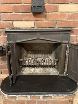

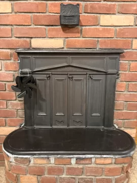

I have a wood stove very similar to this in my house. I have burned a few fires in it after having it inspected but it’s nit a very effective heater.
I was wondering if anyone has any idea about what I could fit In here if I was to replace it. The dimensions just seem much smaller than the new inserts available.
-About 15in depth to the back of the insert and in 15in width in the back
-About 20 inches in height and width in the front.
Any ideas
Any ideas
That appears to have been built in. It might be possible to replace it with a rear-vented stove. If so, it's likely that the hearth would need to be removed, a hearth pad put down, and very possibly a stainless 6" liner installed to connect the new stove to.
Thanks! Do you mean a rear vented free stander? Do you have any suggestion on good stoves that rear vent?
-Ben
Yes, that's right. There used to be more choices. In the used market look at Jotul, Lange, Hampton, Morso. In new, Jotul, Woodstock, Morso make rear vented stoves.
