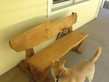

Lastly, my chimney was no dirtier than usual after burning it. I even used some of the slabs to make a nice bench for the porch.

Here is a pic of the bench I made from slab wood.
