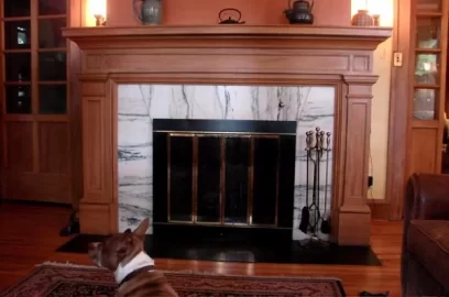

Hi everyone, I've had my eyes on the Woodstock Fireview for some time, and I keep coming back to it, but lately I'm wondering if an insert might actually be better.
Here's the breakdown of my situation.
—2-story house (1100 down; 1000 up)
—No insulation in walls but new double-paned windows
—Centrally located masonry chimney (30 ft) w/o a clay liner
—Good sized masonry firebox that sits at floor level
—12-inch marble surround and wooden mantel beyond that (picture attached)
—Fairly divided floorplan but with large french doors to back side of house
—Open staircase at end of house
—Also, there is some possibility that I will move in the next couple of years and would like to take the heating unit with me
I know I would have to build a hearth pad for the freestanding stove, and I'm planning to install whatever I get with the help of my father.

First recommendation, get some insulation in the walls and attic. Second would be be look at stoves you like and note clearances to trim and mantle requirements. I'm thinking a flush insert may be a good compromise so that the woodwork stays.
I would love to have my house insulated, but the cost is prohibitive at this time. It's a brick house, which complicates the matter considerably. Ideally, I would do both, but I think I will achieve greater immediate savings with the stove, especially in light of the fact that I have a 30-yr-old furnace. My highest bill last year was $460, and that was keeping the thermostat at 66º. I may, however add some insulation in the attic, since that is a little more affordable.
As for the clearances, I've researched all that. The woodstock people say I can put the stove right in front of the opening if I put a little heat shield in to protect the bottom edge of the mantel trim. Clearance does appear to be less of an issue with Hearthstone, but the price is still $500 or more higher.
What do you consider to be the advantages/disadvantages of the insert—besides the obvious matter of not sticking out into the room? Will it heat just as effectively as similarly rated stove?
The advantages for heating are generally with a free-standing stove, especially in a power outage. And it is quieter without a blower. Sounds like you are doing your homework. This will be a nice setting for the stove. Will the hearth will need to be extended a bit?
That's what I thought intuitively, mostly since it has three sides exposed to the room. Yeah, I will build a hearth pad large enough to provide the distance specified by the manufacturer (can't remember the number right now).

I see in the pix your home is very nice, stress to the company to keep it that way.

Regarding the hearth... yes it does need to be extended—8 inches minimum for the Fireview. I just purchased a bunch of slate tile and am planning a hearth pad like the ones described on Woodstock's web site—cement board and tile over a plywood backing—which will just lie on top of the existing hearth tiles and extend out over the hardwood floor. Fortunately, it's not too much of an intrusion into the room. That's one advantage of the side-loading fireview, because most others require at least twice the clearance to the front of the hearth.

The Fireview will look sweet in front of that fireplace and should also help cut your gas bill. It may or may not be a little small in heat output for an uninsulated 2100 sq ft home but you have an advantage that the stove is centrally located and you can always add insulation later. I had 8" of insulation blown into my attic (about 1000 sq) ft 2 years ago and it cost about $500.
If your looking to move later on and take your stove, make sure you don't destroy the fireplace damper area by cutting a hole for your liner to pass, look into oval pipe to fit the damper throat.

I don't like inserts. I had one and tore down the chimney, replaced it with a freestander. However, that fireplace looks really nice and the hearth extension looks nice as is. I think it would be a negative thing lookswise to put a freestander in there. Another reason, you have a fairly divided up house that is big. The noisy blower on the insert will make lots of hot air that should travel better to those remote rooms vs. the radiant heat from the freestander that will do a better job of heating the room it is in.
