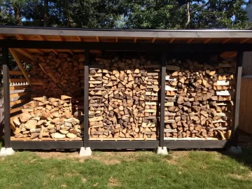

To get ahead, get green maple now for two years from now (split it, stack it off the ground, top covered). Get green oak, do the same. Three years from now you'll love it.
And for next year, pine, fir, cedar, biobricks, pallets, lumber, and if you're lucky ash. Split small, stack off the ground, top covered.
A chit ton of work, but worth it. And the next year's you fill back what you burned and don't have to worry as it'll be there three years after.
Wood burning is fun. The start up is a steep learning curve and a boatload of work - if one or both don't happen, the fun will be much less, and (fire) hazards will be larger.
It may sound daunting, but you can do it.
I built and filled this three year shed (one bay a year) in the first covid lockdown. Best thing I did for my heating ever. No worries anymore about wood quality.
