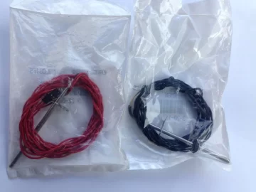

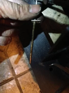

The ESP probe (Exhaust Sensory Probe on a Harman Wood pellet Stove) relays the exhaust temp back to the control panel. A clean ESP probe can do that much more accurately. Just remove the bolt, pull out the probe and wipe with alcohol and clean any rust or corrosion with emory cloth.

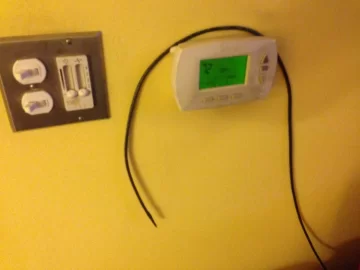

The Harman DVD states to raise the room probe end to 5 feet above the floor to correctly read the room temperature. I changed mine and it really does make the temp dial much more accurate!
See pics below:

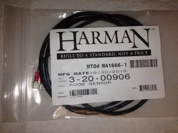

The old standard is the black probe, the new red probe is low voltage.
Dip switch 5 on the circuit board is down for black and up for red.

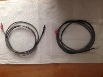

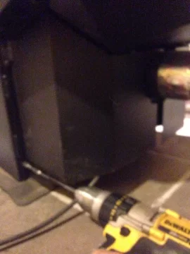

are you talking about the long black wire[2 leads] behind the stove?
Yes, the ROOM probe on the older stoves was gray, but the newer stoves it is black. It cannot measure the room temperature properly if the end is lying on the floor. The end of the wire needs to be 5 feet off the floor to work properly.

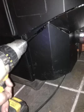

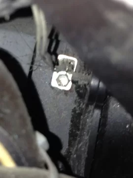

To do this:
1. Remove the lower right back panel.
Loosen the two screws going into the back of the fire box in the rear of the stove. See pic 1.
Remove the top screw going into the back right side of the stove. See pic 2
Slide the panel out.

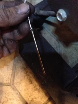

2. Now you will see the bolt that holds the ESP probe into the round exhaust pipe. See pic 3
3. To get more room to remove the ESP probe
Remove the lower skirt flange by loosening the bolts on each side.
Pull the flange down and then pull the tabs out of the slots in the back panel of the stove.

To do this:
