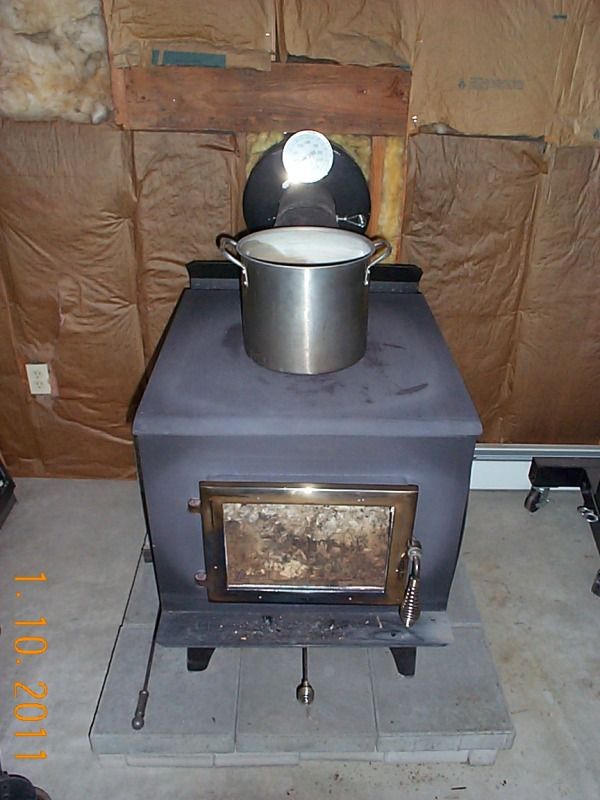

This guy was installed in '96 when the house was built, it has served me very well over the years.
[Hearth.com] Froling wood boiler installation underway!!
It's had an awful lot of help from this guy, but I'm sorry to say I do believe her days are numbered:
