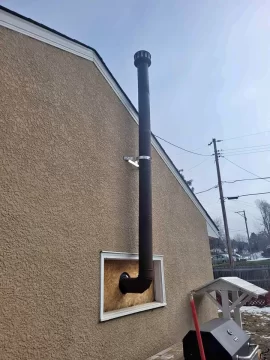

...from a local "wood stove for sale" listing

At least they screwed the pieces together. Wonder what the inside looks like.

What so bad about this the pipe looks solid and insulated and just attached outside and he got it for a good price to make ends meet...Can't one place a pipe outside a building? Writing from ignorance here because I do not know but it looks good to me...clancey
Black stove pipe outdoors = no.
Black stove pipe with less than 1" to a combustible OSB sheathing = no.
If it's your SHTF scenario for very short-term emergency, we could forgive the former, but not the latter.
No.
That’s a structure fire just begging to kill the occupants waiting to happen.
I saw a similar set up with 8” pipe on a backroad up here in Maine one day a few years back. Side of the 2 story house was just dripping in black goo. My foot was tickling the fan blade or I would have stopped for a picture. Never seen anything remotely like it. Ever.
