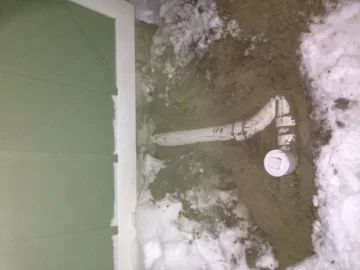

I got the line from the cleanout to the tank open! But now I realize the cleanout is angled and I can't get the headed up toward the house. Any suggestions? I thought the cleanout would just be a straight up T but it's not.

Well, we did it! A serious relief.
This angle in the cleanout is why I couldn't get the hose in going upstream.
The whole thing is only 7 or 8 inches deep. I'm surprised it didn't happen sooner. I'll have to figure out some way to insulate it.

Yes, the hot water did the trick! If I could have gotten the hose headed upstream toward the house, I would have been done in no time, but just couldn't make the bend. There isn't a trap close to the foundation on the inside and I didn't have a vacuum, so I'm really glad I could thaw the pipe from the outside through the pvc. Putting more water into the system was what I was trying to avoid (it was coming up out of the floor drain in the furnace room).
