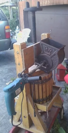

    I don't have any experience but this is the contraption I'm experimenting with if it gives you any ideas.

    I didn't buy it but I think it is the Homesteader. Not sure how well it works but it has been in the family for a couple decades.
    https://www.happyvalleyranch.com/?gclid=CL_EgoKD6qMCFeQD5Qodm16i0w
    It has a big cast flywheel type weight hand crank. But, this is tedious for a one-man operation. I am getting the parts together to power it with an electric motor as I damn near burned out that cheap drill in my experiment and it stopped on every apple. When it did work, it sent 4' of spray out. The basic design seems to make sense just need to fine tune the powering of the masher.

    Replaced the drill nonsense with the original flywheel hand crank while it was raining today. Made cider with some of the neighbors apples that would otherwise go on our compost pile...good stuff.

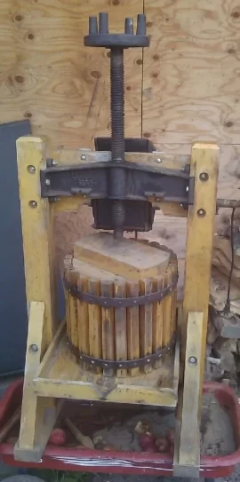

    I have one of the rectangular frame presses with a hydraulic jack, similar to the picture from BackPack09.
    My father built mine years ago. You set up the apple pulp in cloth bags, topped with a birch slat rack covered in paraffin wax. You a make a stack of about 4 bags+slats, then a solid cover piece, then the jack.
    It is slow and frustrating because the travel on the jack is not enough for a round of pressing.
    So I have to jack, release, shim, rejack etc.
    It all works, but I would prefer a better system.

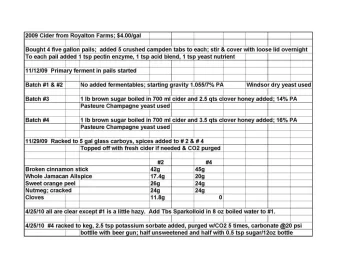

    I received the cider recipe in Excel format, so here it is as a jpg:
