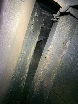

Next step = the liner. Or lack thereof. It's just bare brick as far as I can tell. I think I need to install a stainless steel flexible liner. Since this is a fireplace, it looks like I would use a mesh base plate to accept the liner at the smoke chamber -- and would then need to parge the smoke chamber where the liner terminates. However, the damper is in the way of the smoke chamber. Removing the damper looks like it will involve some destruction! And after removal (if necessary), is the best option to install a top mounted damper?

For now, plunk a plate of metal or plywood on top with a cement block as a weight. Dampers are often cut or removed to facilitate a liner.

As far as the long term solution goes, I'm sure I will need to remove the flue in order to put in a liner. I'd like to then install a top-sealing damper. Could I skip the crown, use a chase cover, and connect a top-sealing flue at the top? So the configuration would be smoke box > liner > chase cover > top sealing flue. Does that work?

Have you thought of using a wood stove or insert since you are putting in a liner? You would get more heat in your house from burning wood. Then you could skip the top damper.

I like the idea of the wood stove insert, I would just need to do some research on the cost and install. There are quite a few used inserts on facebook marketplace, so that could be an option to save money.
I did see the Rockford Chimney Supply chase cover - seems like a good price and they have a lot of helpful information on their site. For now, the chase cover with a blank cap on it seems like the way to go. The problem is that I don't know what size hole I need until I choose an insert. Or decide to go with the fireplace... which would mean I pull out the flue, parge the smoke box, install a top sealing damper. The insert is sounding much better to me at this point. Especially if I can find a used one that would work.

The rain and snow drips probably fall on the smoke shelf and either dries or seeps into crevices.
