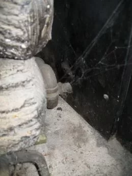

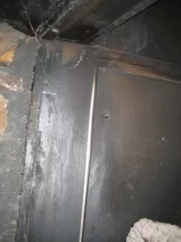

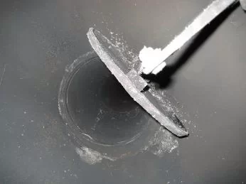

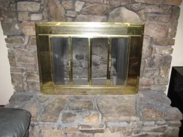

I just installed a wood burning insert in place of a gas insert.It seems like you may have a metal "heatolater" firebox like I have. May be best for you to take a few pics and upload so we can see what you are dealing with.
Hey guys -- attached you'll find some shots of our fireplace and the dimensions I'm working with...my estimate before was a little off. What shape do you think I'm in? Thanks for the help!
  • [Hearth.com] Gas to wood burning insert
