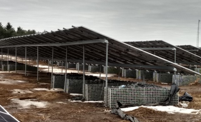

Our local installer has been doing a lot of installs like this lately (I borrowed the below images from his FB page). Obviously he uses concrete instead of rocks and isn't a "geo" system but the concept is the same.Here there's a few reasons for it, cost, it can be cheaper than installing piles. Permitting, by sitting on concrete blocks it can be considered a temporary structure to many jurisdictions and lessens the requirements compared to if it were installed on piles.
The downfall here is frost, in our ground conditions we can often get surface heaving of the ground in winter as the water in the soil expands and freezes (froze heaves), where piles would be installed deeper than the frost and remain stationary. To some it's also un-sightly having big concrete sitting above ground in the yard.
I do also agree with @semipro that you'd be better off to nix the optimizers and install more panels instead. In our area optimizers are priced at a premium and you could probably install 30% more panels just from the cost savings on the optimizers.

@ABMax24, the pictures you provided are just the sort of ballast that my neighbor has for his very large solar array. I think it was done because the ground is rock here. The water table and frost are not issues in this area. There are flash floods, though, at times because when the "frog strangler" rains do come, the water can't soak into the hard ground, and it runs off.
@begreen, the article you linked is just what the owner of the company was proposing. He was very forthright that he has not used this technique before, but it was recommended to him by an engineer for our site, because it is very rocky and also not easy to access. There's no hope for a concrete truck. Pictures don't really capture it, but I took a few tonight just to give some idea. We would be glad not to have additional concrete poured into our ground and could get over the aesthetics of the ballast baskets for that reason. It was just such an unfamiliar idea to me that I wanted to see if anybody had more knowledge.
