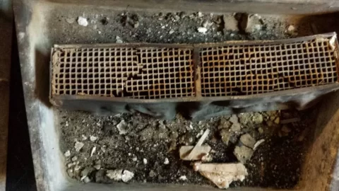

Having a stainless steel insulated liner put in today. When prepping stove for removal found some damage. Melted the cat.
[Hearth.com] Getting a stainless liner installed and found over fire damage[Hearth.com] Getting a stainless liner installed and found over fire damage

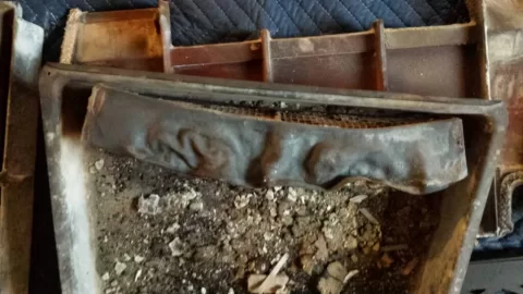

I remember overfiring and getting the throat red. It never really burned right the last month of the season.
I guess I know why now.
I also think I smoked the refractory box.
I guess I learned a valuable/ expensive lesson.
That's too bad, but I doubt this happened after only one overfire. The fact is, most all vc's look that way in the back after a few short years. It's too bad.
Is it winter warm?
I don't blame you, I blame the crappy VC design. I wouldn't spend much money on repairs.
Sorry, but just going to say it how it is....get rid of that money pit, and get yourself something new and more hassle free.

Find out how much that will cost to redo that thing, I am guessing you will be over $400 in parts, the refractory backs are an arm and a leg.
I see two routes for you if money is tight:
1. See if a friend has an old insert sitting around you could put in there or find one on CL, should be easy to get an old steel insert to hook up to that 8" liner to burn temporary till you find the money to buy a real stove, estimating about $200-$400 depending on condition.
2. Find a used newer catalytic insert like you currently have (but steel) that will work on the 8" liner, brands like Buck, Appalachian, Kuma, High Valley would be good upgrade candidates, some of these can be found used for $700-$1000 depending on condition.
Just the cat and refractory are around $500+. Im assuming other parts are warped. Such as the left and right throat. I would consider looking at something new
