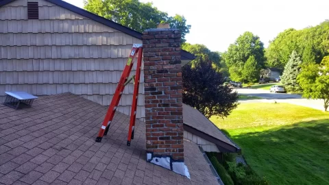

Duel 8x8 terracottas and there is no other appliance in this chimney. Im guessing i should pull or break them out. Looks to be 5 2 footers stacked x2, top 2 i can just pull out and might be able to pull them all out.
If i pull them all how do i finish the top?
I can actually shimmy dwn behind brick wall where the wood storage area is. Would love to insulate the inner brick wall but i think ill just great stuff some dow board up in the attic and lay the insulation back down this way the cold attic air isnt getting down there.
Had some carpenter ants around the chimney/rafters due to the flashing having some holes. I sprayed them and siliconed the flashing, have to see if their any where else. Prolly gonna change the lower back 2x8 which they were in.
Heres some pics, chimney is roughly 16'.

Why pull out the clay liners? You can fit a 6" diameter stainless liner in there, can't you?
Where does the other flue go to, the basement? Can't have too many flues. :)
Not with insulation you cant and it clearly does not have the required clearance so it needs insulation
And they are all stacked crooked! It will be insulated, superflex from sleepy hollow chimney. Just curious, what clearance doesnt it meet? I just see the chimney going right up through roof, are the rafters too close?
After pulling clay liners do i install one 12"x12" up top?
You need 1" between the outside of the masonry and any combustible materials And 2" for interior. But a properly insulated ss liner gives you zero clearance on the outside of the masonry. And no you don't need to put any clay back in just the stainless

How does the top get finished? Just a stainless flat top plate that holds the liner up? [Hearth.com] Getting ready for my hampton insert install
Well you will need to do some masonry repair then either a masonry crown or a stainless top plate to cover over the whole top. As far as gettin the rest of the liners out we break them out using special equipment. And no it does not need a class a
Its a pretty big area with out the clay liners, would the stainless top plate bow in and collect water? I plan to repair the top layer of brick, should i get some bluestone or something to close it in a little?
You could do that or just use heavy enough stainless that it wont sag
