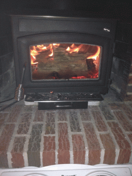

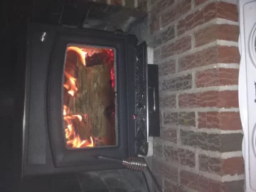

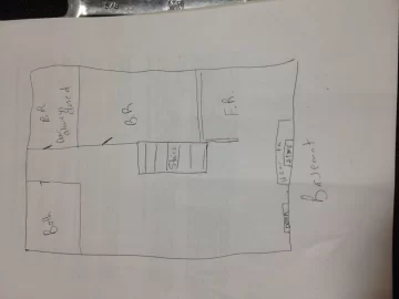

Can you post some pictures of your install? How big is the room the stove is in? Are the walls insulated?

Outside temp was mid 20s when I got it up to 77. I had the basement door closed that is at top of stairs cuz my 1 year old was running around. The basement was nice an toasty everywhere except the back room where we keep door closed. This is my first wood stove. When u say air combustion I'm assuming that's the lever on the top right. It goes left to right. I would like to be able to get the stove cooking the basement up so maybe some of that eat will go upstairs when the door is open to try an take the chill off. 3.39 a gal for propane not really my fav thing to pay for

Walls are insulated and so is the ceiling. Also has new windows downstairs. Total area downstairs is 1000 sq ft minus that bedroom we have door closed so prob 850-950 sq ft
Follow the operating instructions on page 15 of your manual. Like I mentioned earlier it may take a few fires before you get a good, clean burn out of it. If you don't have the manual it can be found here:
http://www.hayneedle.com/images/PDF/UNIT011.pdf
If you cannot get the secondaries to launch or get it to burn smoke free you may have one or both of two problems. First, your wood may not be dry enough. Check it with a moisture meter ($20-$30 at Harbor freight or home depot). Or a draft problem due to the direct connect. A full liner should correct this.
