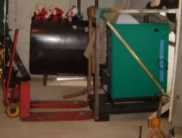

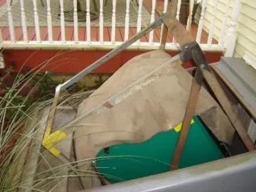

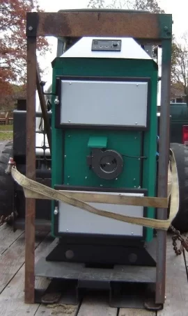

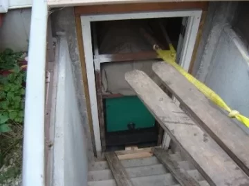

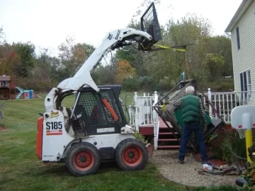

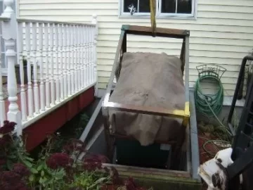

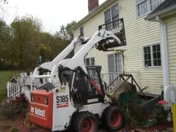

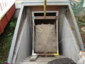

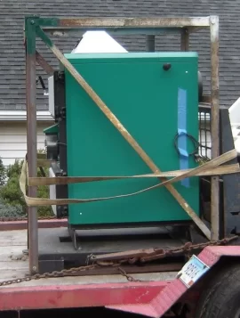

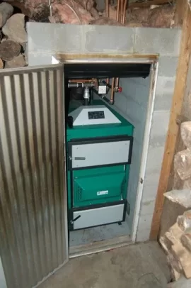

Here is a delivery of an EKO 25 into the basement, down a set of non-removeable stairs.
The boiler was tipped on its back.
Set down on 2x8s for guidance.
Step 1 build a framework.

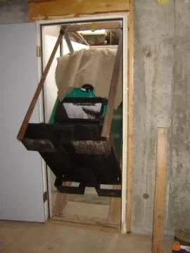

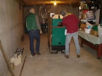

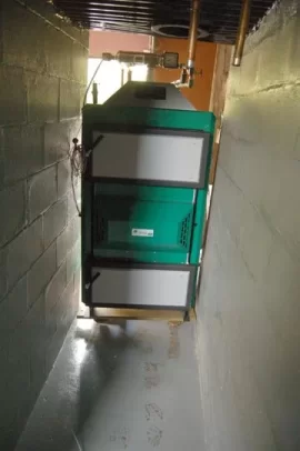

Step 3.
Tip up and roll into place.
Remove framework.
Doors and ceramics were removed to lighten it up a bit, but other than that it went down the stairs whole.
Do not for any reason get below the boiler!
Use straps that are rated for lifting.
And just be careful.
Good luck, hope this helps.

Holy smokes - and I thought having to completely disassemble my slider was a pain in the butt. That is quite a tight fit right there, Rich. Nicely done. Nice to have the right equipment for the job too....

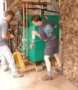

I like the narrow pallet jack. When we moved my 60, I had to jack it up onto blocks in order to get under it with a conventional 'jack. Tight squeeze, too!
