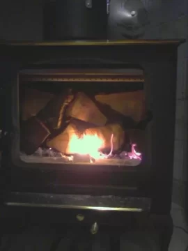

Here is a pic of a typical load in the 30. This would be a overnight load or first morning load. During the day there is usually smaller loads running. This was loaded at around 10 pm and was reduced to about 2 gallons of coals at 7 am.
  • [Hearth.com] Getting the NC30 to heat as well as the old Defiant
Those splits look pretty large. I bet if you took half of that load and split them in half your stove temps would come up much quicker and the stove would throw much more heat. Maybe you need to burn smaller splits during the day for a hotter burn and save the large splits for the overnighters?

I am with Todd on this one. I have experienced just that with smaller splits in my 30.
If you want to burn bigger splits and get quick heat I would suggest a middle of the road wood like cherry, green ash or silver mape, so far some of the best and most predictable fires have been with Green Ash, I know what the stove is going to do for the most part, it's as close to set it and forget it as I can be. Oak and White Ash come up to temp slower so smaller size splits in those types are the order of the day for me.

I thought those stoves weren't supposed to have wood above the firebrick? That one is loaded to the tubes.
I always loaded my non cat to the tubes when I wanted a full load. If I only loaded to the bricks it would've been a 1 cubic foot stove. :lol:
