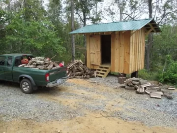

Build a woodshed like mine. It dries wood in 7 months.
Reactions: Durantefarm

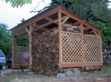

Looks like there isn't a lot of ventilation there. Ours lets the winds blow right through it.

No, my woodshed has no ventilation. It works because water vapor will pass right through the wooden walls and floor.
On sunny days my woodshed gets real warm.
On rainy days, and on foggy nights, my wood is not exposed to moisture-laded air.
@Simonkenton and @begreen those are some beautiful wood sheds!
@Simonkenton, what is it about your shed that makes it dry wood so quickly? How many cords does your shed hold?
@begreen, how do you feel about his with closed sides versus yours that lets more wind flow? How many cords does your shed hold? Looks big!
Of course it is. The humidity in the shed is most likely going to be the same or higher than ambient. If the wood walls let the humidity out they are not going to do a lot to stop it from coming it. I'm sticking with the best wood shed design is open and oriented so that the prevailing wind can blow thru the stacks.
kennyk. our wood shed holds 3 cords per bay.
One thing I like about this design, and I incorporated into my shed, is the pallets for the floor. That way the shed doesn't have to support the weight of the wood. If/when the pallets go bad it's quick and easy to replace them.
