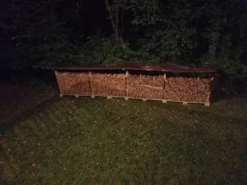

I had good luck with this single row covered rack I made. Just the standard cinder block design with some uprights to hold a 4' wide tarp. It holds 1/4 cord per segment and can easily be taken down or moved. I got some recently dead ash cut and split @36% in June 2017 and by December it was reading 18% (measuring a fresh split with the grain). Smaller splits with lots of sun and air. I'm surrounded by trees but it get's the most sun as possible. I think the single layer makes a big difference. It was burning great this winter. It's not very space efficient but that is as fast as you'll get without some type of solar kiln.
My Norway Maple on the other hand was going slowly. It was CSS in March, moved to this rack in June and is sitting around 24-26% now.
I may expand it to 2 cord to fence the rest of the tree line... The other 3 cords are slowly seasoning tarped on pallets in the woods.
Good luck.

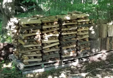

I split most of the Norway Maple before the blizzard - about a 1/3 of a cord. I made the splits thin for the most part and stacked in a double row, though I can adjust that, and stacked alternating direction - not sure if that makes a difference or not (I've heard mixed opinions). Pic below (need to work on my stacking skills a bit!) I have a few more rounds of the Norway Maple, and another third of a cord or so of cut rounds of an unidentified tree (need to work on my tree identifying skills too!) that fell in the "no man's land" between a few abutting houses onto my property this past fall. I also have at least another cord or so of the rest of that tree, which is mostly suspended off the group and perhaps another cord of another tree that has been on the ground for a couple years (I have to look to see what condition that's in). My very nice neighbor, with whom I share a back yard (we live in a single family attached house, like a side-by-side duplex), is going to give me a chainsaw less to go at these!
I had my N Maple crib stacked uncovered in the woods like that from March- May. It was raining 5 days a week on average. I quickly changed my mind and got a tarp just for the top. I had exactly 1/3 cord, 4x8x1.5 regular stack. It came out to eight 4.5' tall cross stacks. Still wasn't ready by November with the cover.
I also find if you cover the top and a little of the sides with black rubber roofing that black absorbs serious heat from the sun and will bake the moisture out of the wood.Just don't cover the wood totally so the moisture can escape.
