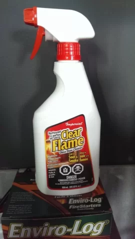

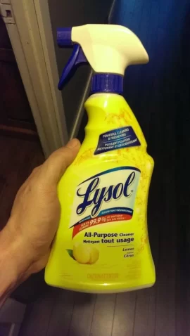

If there is any one out there like me that is very anal about their stoves appearance then I thought I would share this with you.
I do not like it when the glass on my stove door is black (or starting to get black). I use my stove for heat but also as a focal point in the room. I have been trying to keep my glass clean and whenever I seem to get it clean, by the next fire it seems to be getting black again. I have tried many different thing and have stumbled on something great .
First I use "imperial clear flame glass door cleaner" and then I use "lysol all purpose cleaner" which is a great glass cleaner. After it dries (about 3 minutes or so) I light back up again. I can burn about 5 fires before I even start to see any black soot starting to build up.
Any one else have any other ideas about how they keep their glass clean?
