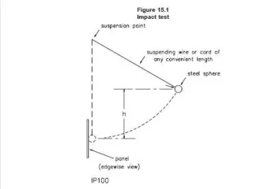

Per the UL safety standard for wood stoves, the glass must pass a few tests...
With maximum intensity fire.
1. Wipe down the glass with a rag fully saturated with room temp water
2. Three sprays of water from a suitable spray bottle.
Before, during, and after a radiant fire.
1. Impact test
See the attached drawing for the impact test. The steel ball in the impact test is 1.18 pounds and "h" is 16.25 inches.
