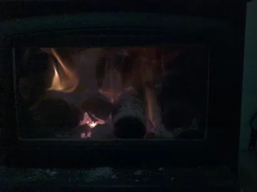

Does the fire look like this while it is going?

No, I have more flames even when it is turned all the way down.
I suggest checking the door adjustment. Do the dollar bill test on the door.
You should not have a flaming fireball very long after shutting air back.
